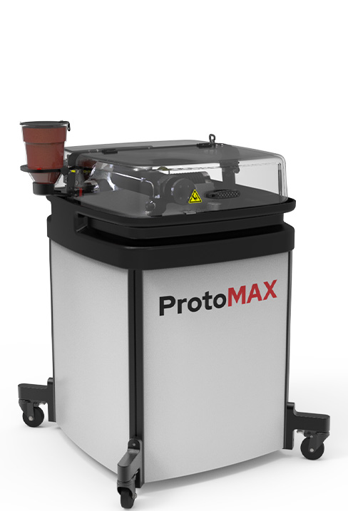

What is ProtoMAX?
Designed and built alongside the revolutionary OMAX waterjets, The ProtoMAX is a compact, self-contained cutting system ideally suited for prototyping and low-volume cutting of almost any material approximately 1" thick. Bringing all the versatility benefits of large abrasive waterjet cutters together in a sleek and economic package, this machine is ideal for prototyping or as a complement to a larger machine shop.
![A person operating the ProtoMAX](/sites/default/files/styles/coh_large/public/2022-01/Bendigo%20at%20work.jpg.webp?itok=23OtsiqD)
KEY FEATURES
Traverse speed up to 100 in/min (2,540 mm/min)
with ±0.005" (±0.127 mm) linear positional accuracy
Electrical 230-240 VAC single phase, 30A, 50/60 Hz
Easy to install Pre-install Kit to help you prepare for rapid setup 3-4 hours.
![ProtoMAX Machine](/sites/default/files/media/protomax/ProtoMAX-Key-Features2.png)
Dimensions: 39.5" x 56.5 x 41.5
(1,004 mm x 1,435 mm x 1,054 mm)
12" x 12" (304 mm x 304 mm) cutting envelope for materials up to 1" (25 mm) thick
30,000 PSI (2,068 bar) direct drive 5HP (3.7 kW) pump technology generates best-in-class power
Laptop computer with pre-installed professional software included.
